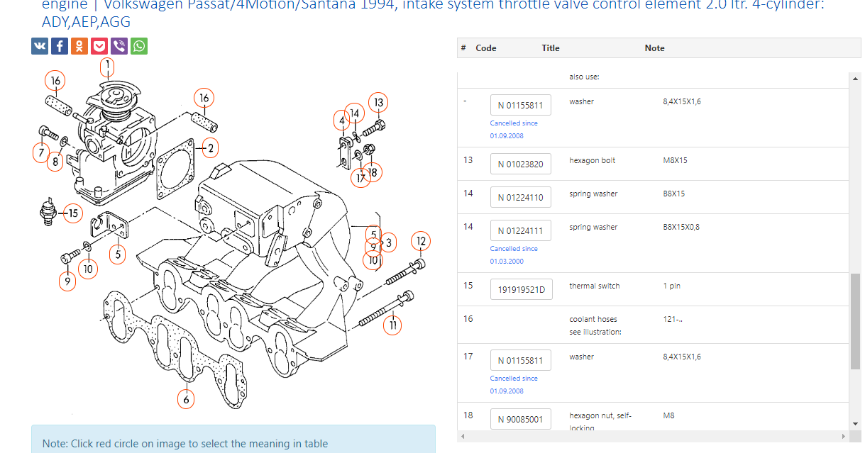

Otsin infot kuhu ühendub ADY mootoril sisselaske kollektoril olev temp lüliti? Juhet enam ei ole, vaja teada ECU pin-i numbrit või siis mootori küljes oleva pistiku pin-i numbrit.
Positsioon 15.

Venelaste foorumist:
This is a hood temperature sensor (relay type). It turns on the radiator fan after turning the ignition off (and possibly pumping fuel) when the permissible temperature is exceeded. (Autoran system). I think it has nothing to do with your problem.
His number is 191919521D. On Passat B4 there is no circuit at hand, but there is on Volkswagen Passat B3 (S24)
